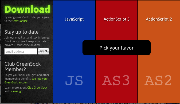

Once you click on that, you will see three choices. Click the Javascript library download and then download the zip.
[![2](https://blog.elblearning.com/hs-fs/hubfs/Imported_Blog_Media/2-575x334.png?width=575&height=334&name=2-575x334.png)](https://blog.elblearning.com/hubfs/Imported_Blog_Media/2.png)
