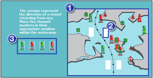

1. The Drop Image: An image that represents the region to which items are dragged.
2. The Drop Zones: The specific areas of the image that represent drop points.
3. The Drag Items: The images or text that need to be dragged onto the drop image.
Drag and drop vessel returning from sea example

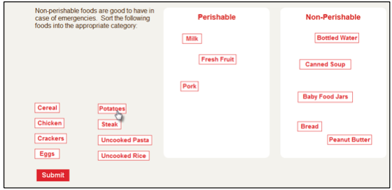

Many to One (Buckets)
many to one drag and drop buckets example
This type of Drag and Drop question is appropriate when a learner needs to categorize a number of options. In this scenario, multiple drag items are correct for a given drop zone or bucket.

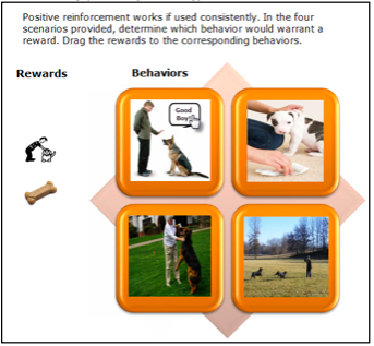

One to Many (or Many to Many)
one to many drag and drop example (with dogs!)
You may want to develop this type of question when one option (or drag item) has more than one correct answer or (drop zone). In this case, you will indicate that a drag item is correct for multiple drop zones.

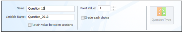

2. Enter the Basic Question Info.
Just like every question type in Lectora, you’ll need to specify a name, variable, point value, whether to retain the value between sessions and if you’d like to grade each choice individually.

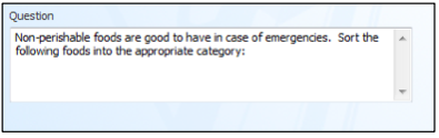

3. Enter Instructions.
Within the question text, provide clear directions for the learner to successfully answer and submit the question.

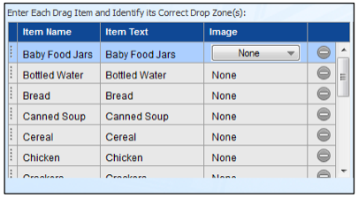

5. Add Your Drag Items.
Drag items can either be images or text, or a combination of both. Either way, your learner will drag these items onto the drop image. You can modify or delete the default drop zones that Lectora provides.
Lectora question creator screenshot 4

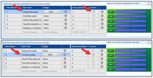

One to One
: For each drag item, only one drop zone would be selected as the correct answer. Here, Drop Zone 1 is correct only for “Inspect the plant”, and Drop Zone 2 is correct only for the “Smell the plant” drag item.
Lectora question creator screenshot 5

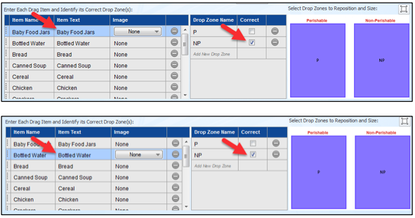

Many to One: More than one drag item can have the same drop zone selected as correct. In this example, the “NP” drop zone may be selected as correct for both “Baby Food Jars” and “Bottled Water”.
Lectora question creator screenshot 6

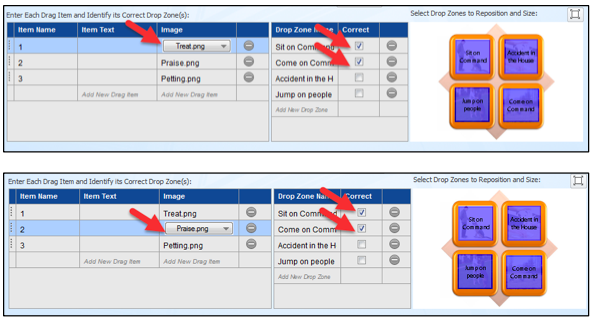

One to Many: More than one drop zone can be correct for a drag item. For this scenario, when you select the “Treat” drag item, both the “Sit on Command” and “Come on Command” drop zones are considered correct. These same drop zones are also correct for the “Praise” drag item.
Lectora question creator screenshot 7

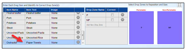

8. Optionally Add Distractors.
Distractors are either additional drop zones that do not represent a correct answer or drag items that do not have a correct destination. Adding distractors introduces an extra level of complexity to your question and reliability to your assessments. To add drag item distractors, enter images or text and do not select a correct drop zone. To add drop zone distractors, add a new drop zone, but do not select it as correct for any drag items. Here, you can see that “Paper Towels” acts as a drag item distractor because it does not have a corresponding correct drop zone.
Lectora question creator screenshot 8

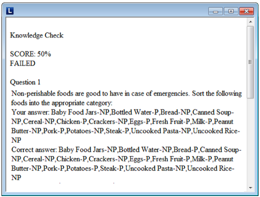

What’s in a Name?
The Item Names in drag and drop questions serve several important purposes. First of all, they help to keep things clear and organized. Naming your drop zones will help you identify the correct ones more easily.
Secondly, the item name represents the value used in the Question’s variable. When a learner submits a drag and drop question, the variable value is populated with “Item Name-Drop Zone Name”. This is how the user’s answer and the correct answer will be displayed in your Test Results. Further, this is how the answer will be reported to a learning management system (LMS). The Test Results shown here display a drag and drop question where item names are specified.
Lectora question creator screenshot 10
